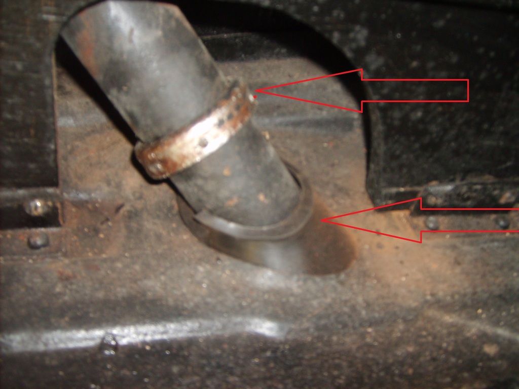

I'm posting a picture I got from terrill when he was helping me with the trunk area of my 36 std town sedan. The top arrow points to the area that terrill mentions and is the joint between the neck from the tank, and the extension that extends out of the body. I believe this is what GeorgeB is saying is leaking. The bottom arrow is what terrill refers to as the rubber boot gasket that seals the hole in the trunk floor.
[Linked Image from i1243.photobucket.com]

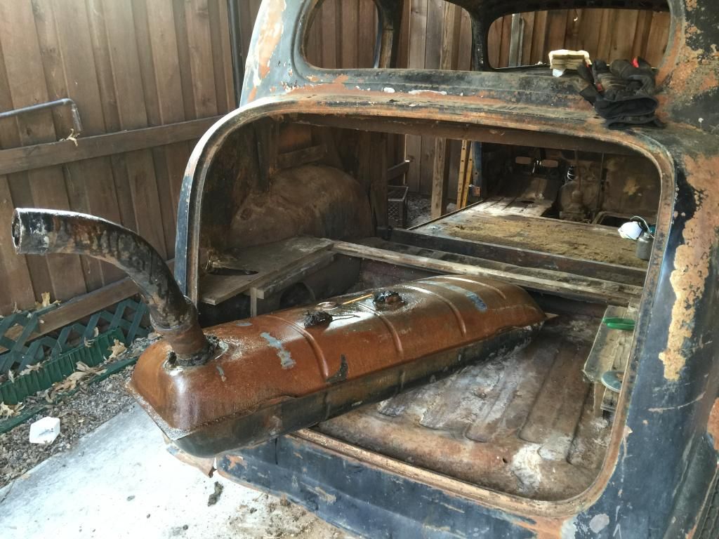

Another picture showing a tank and filler tube.
Gas will not leak out of the lower location as the 1936 Engineering states "A heavy rubber seal prevents the entrance of dirt and water To the trunk area"
The top seal joins the neck to the lower neck extension. There is states "The two necks are held together with a threaded metal coupling in which a CORK seal is provided to prevent gas leakage".
