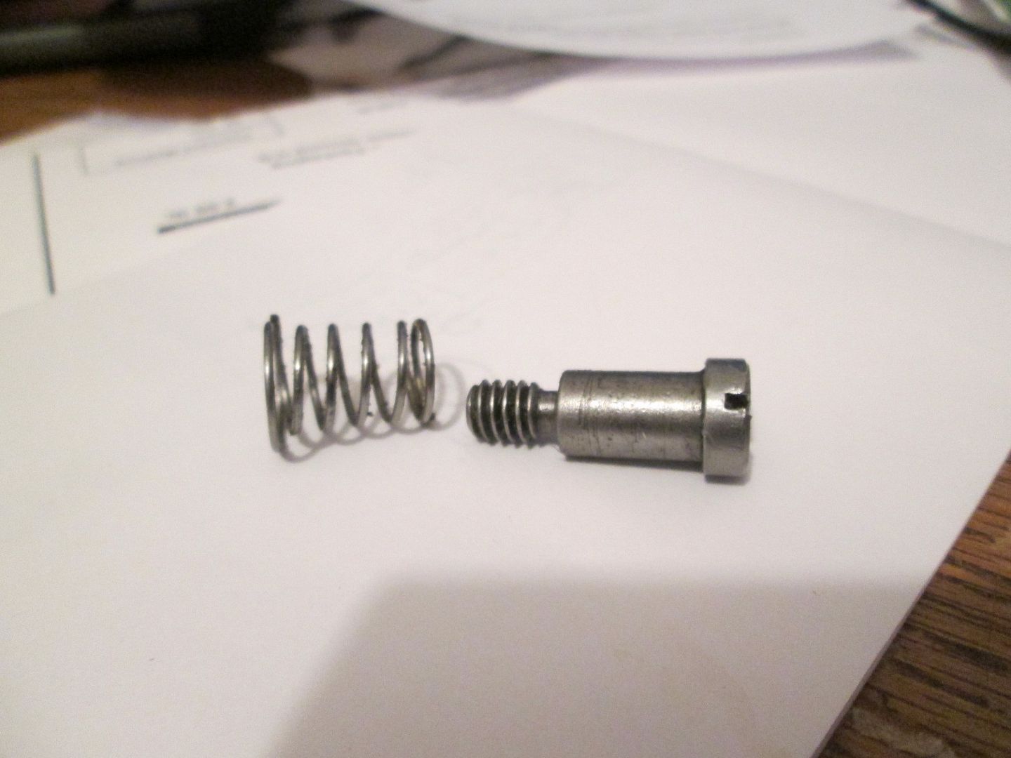

No.5 had two .002 shims on one side and a Stack on the other side. I ended up with three .002s on each side at which point it didn't move by hand any more but did with the hammer. So I left it like that and buttoned her up. Went for a ride . The knock seems to be gone but the clatter remains of course. Only one part left. This shoulder bolt fell out of the side pan. It looks like something that should go on the distributor. I looked from above, and from below but can't figure where it goes. I'll have to dig out the parts book. ![[Linked Image from i1176.photobucket.com]](http://i1176.photobucket.com/albums/x324/landman2/IMG_4259.jpg) I'd like to thank everyone for their concerns and advice. I will purchase some pushrods, ball studs, some tappets and 216 valve springs. Everything else was new at the time of the rebuild. Meanwhile I'll wear earplugs instead of my hearing aids when I drive it and we should be ok for the rest of the summer. Come fall, I'll tear into it again.

Delete "when spark knob is pulled out"....has fullly automatic vacuum advance in 1934.
