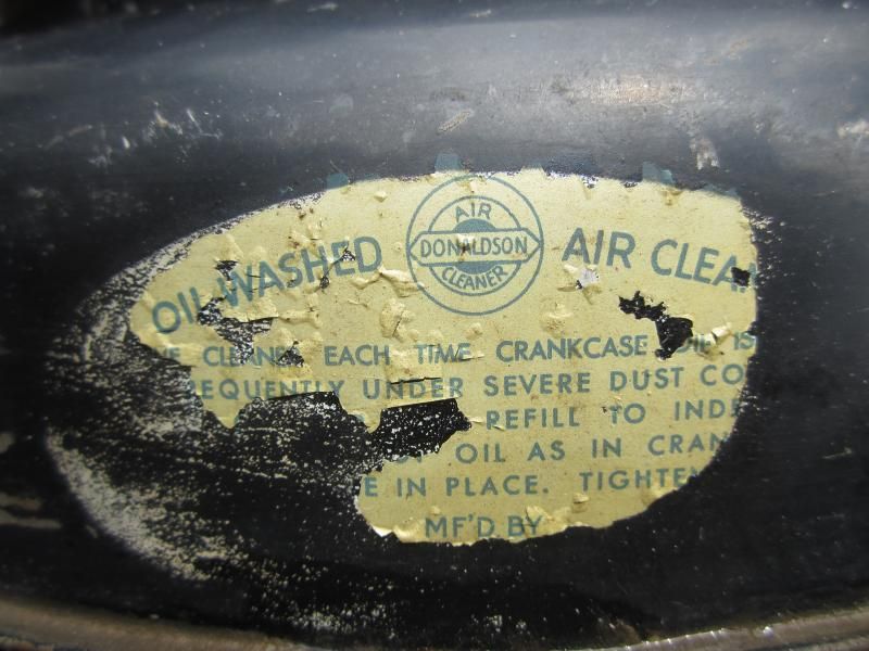

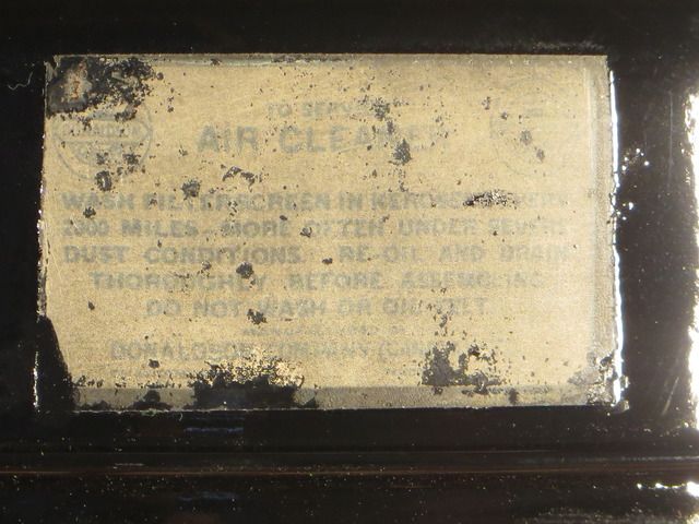

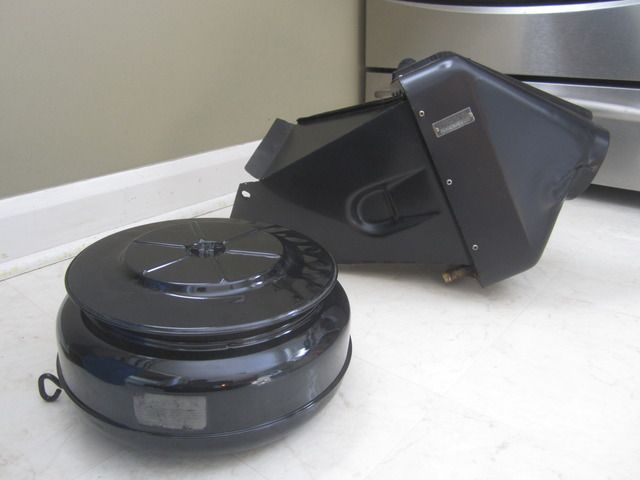

Third, I decided to have him see what he could do about my air cleaner. It has a rare Canadian "Donaldson Air Cleaner" sticker on it... or what is left of one! You can't buy a reproduction one anywhere. I asked him to mask it off, so that if I'm unsuccessful in duplicating it, at least I'll have something. The part looks beautiful now, as he used a gloss paint. The sticker is the worst thing about it!
Here's the painted air cleaner and the heater box with "Oshawa Canada" metal tag...

This is what we had to work with...
We also have this partial sticker from an oil bath cleaner that shows the colours better, as well as the logo...
You can see why I didn't have my hopes up! Anyway, Paul showed me a couple stickers he did for his windshield washer bottle. They looked really good, so I went home with some optimism.

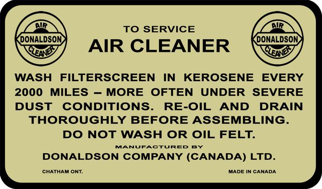

Late last night, this was in my email box...
I'm going to get a few of them printed, and try one out on a spare air cleaner I have here. If it works, I'll sand and paint over the old sticker, and print this one to go over the masked off area on the cleaner.

Looks great ! What will you use to adhere the new one to the cleaner ???
Dick
I've got some clear water slide decal paper that is used for model cars. I'm going to give that a shot first. I'll also prep the part with some decal set.

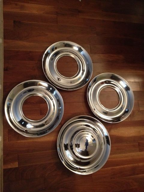

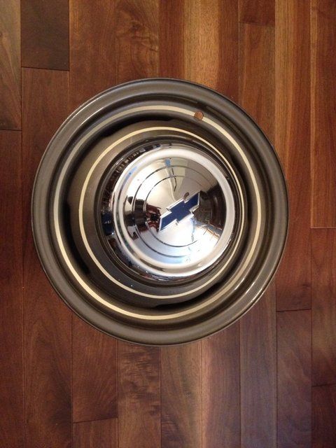

Five rims came back from the pin striper today. Stripes in Crofton Ivory...
I also picked up a set of optional trim rings for $100CD on Kijiji ... That's $75 US today!!
Now I have to decide if I cover up the pin stripes, or put them on the convertible. Likely going to go on the '50 for now... at least until judging of the '51 is done.
If they are like mine (genuine original) they have the gripping fingers on the back which will scratch off the paint .

Shouldn't the stripe be Argent Silver, with Shadow Gray body color ?

Bob, Bob, Bob... Canadian Colours!!! canada
The grey is Aldershot Grey Metallic. The shade is about half way between the two USA greys...
There's no gripping fingers. They push over the hub cap clips and are held on by the hub cap.
