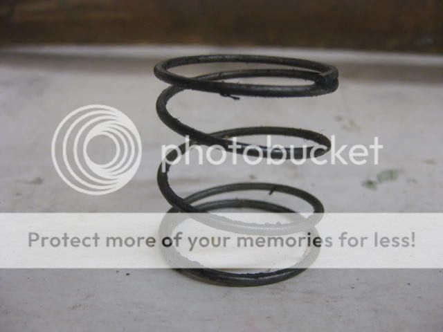

Got a call from Curt Kennedy Friday about the spring in the linkage shown in David's first picture. Curt felt that the spring David was using was to stiaff for the application. He was missing his original spring and wondered what the original one looked like. Here are two pictures showing the original spring. The approximate dimensions are 1 1/4th inch is outer diameter, 1.28" is the length and .069" is the thickness.

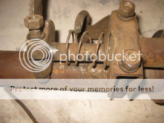

"the shift lever seemed a little "soft" inside so I replaced the spring in the picture and fooled around with the 2 bolted clamp above the spring...I was shocked to find that it has made a HUGE difference in the shift eliminating ALL of the grind into second and 95% of the grind into 3rd. Downshifting from 3rd to second still needs to be done at 10 MPH or less to avoid the crunch. A slow shift is necessary , no speed shifting. The spring is a 1 1/8 X 3 x .105 from Ace Hardware.....had to cut and try 3 times to get the right "feel" on the shift lever inside the car. This made my day and I hope it might help someone out there who is having the double clutching blues!"
I think David solved most of his problem with the adjustments he made in the linkage, and the speed of his shifting.
