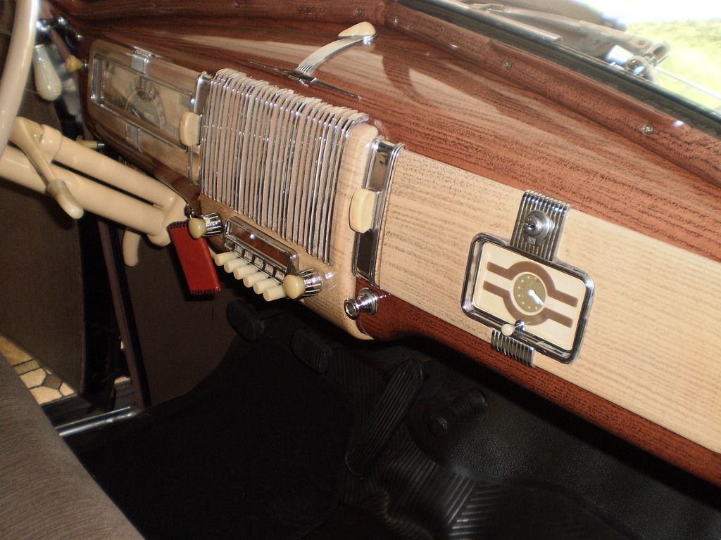

Ruscar, The 41 pictured has all the interior painted correctly but on my monitor it still needs a touch of purple and a little metallic. The wood grain is right and the tan stripe on the door garnish is correct. It should have a black floor mat without carpet inserts and the seat cloth is not right, but nether of those are available.
I think there were 22 pieces I painted for a region member's business coupe.

All, When I took apart the dash from my 41 Special Deluxe convertible it had the tan pink paint on the bottom under the steering column bracket that matched very closely to that available from Chev's of the 40's. Under the edges of the instrument panel however, was a tan brown color that the wood graining on the upper dash was applied over. My opinion is that the entire dash was initially painted that tan brown color as a starting point and then the wood graining and tan pink applied. I also am of the opinion that the tan brown was the same color as the dash in a Master Deluxe that I once owned.
In order to match the tan brown base color I used the Dupont Spectramaster SOLID Custom Paint Chip Color Library Book that our local Dupont paint supplier has in their paint room. The book has hundreds of solid color paint chips with a hole in each one so it can be placed over the original paint as a matching tool. Color number YS231 in the color book was a close match to the original tan brown base color. Much to my surprise, it is the same color Grain-It Technologies recommends for use with their 41 Chevrolet dash graining kit. Although I had YS231 mixed as a base color since it was going under wood graining, it can be mixed as single stage enamel.
If anyone cares to see what the Dupont book looks like, there is one for sale on EBay currently at a price that will scare you!
Here is a close up of the base color on a 41 dash.

Mike (minetto) I was hoping you'd add your expertise to this thread. That's the best 41 re-grained dash I've seen, congratulations on a job well done! I can't wait to try it myself. The base color is still too light for the master deluxe dash and it has a fine metallic. Good advice to using the standard color chips that's how I matched the cameo cream on my current project.

Attached are a few pictures of the dash from my 41 convertible that I have kept unrestored for reference purposes. The original wood graining under the ash tray is very evident and depicts the color, detail and angle of the grain. In addition, the original tan brown base color can be seen to the left of the instrument panel hole. Note the dabs of Chev' of the 40's tan pink below the original tan brown paint for reference. This same photo also shows where the wood graining stopped and the paint started on the vertical axis. The original tan pink color can be seen adjacent to the radio opening. Both of the original colors appear to be solid. Mike
[Linked Image from i1035.photobucket.com]
Note should be made that the convertible was a Special Deluxe. The dash was NOT the same for the Master Deluxe.

You can't argue with original. Minetto's coupe is what you want to match. The color on the W/S divider is the wood grain base coat and is lighter than the dash.
