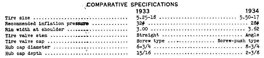

Hi Don,
Supplier unknown, but according to the 1934 Chevrolet Engineering Features book, available online at GM Heritage Center on page 54, shows a comparison chart for 1933-34 tires and 1933 it is 5.25X18.
Most of the tires I've seen in the past were marked 5.25/5.50X18.

Basically the 5.25/5.50X18 is the available tire size. This double size works fairly well, however if you have spares in the fender(s) and have a rear mounted spare with the metal cover, you will experience a situation where you have to let some air out in order to mount the tire(s).
