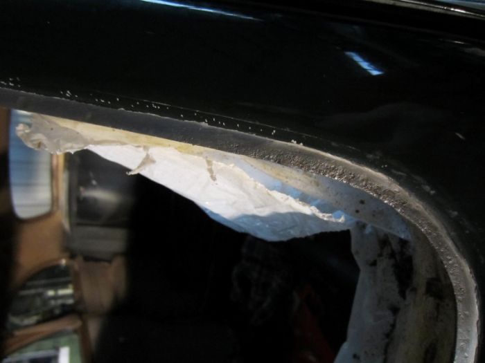

After removing Rust and do a little Paint Job with Rust Prevention it was Time for the Final Paint.
Now i would mount the Chrome Molding on the Window Frame. But look at the Pictures, is it possible to get this Molding on the Frame? It is the original and was not damaged at any time. Any more tipps for mounting? In the molding i will do some 3M Sealer
IMG_7984.JPG IMG_7985.JPG IMG_7973.JPG 09_01_16.JPG 09_01_7 (Andere).JPG 09_01_17.JPG

Yes, it is possible to reinstall it. Start in the lower corners and work towards the middle from each side. Then up the vertical sections and across the top. It will slide down over the pinch weld. I started mine lightly all the way around to make sure it was positioned correctly and then tapped it all the way down. I used a light rubber mallet to tap it down. Your choice but waited until my final finish paint was completed and then installed the trim first and then the windshield,

Do you have the pinch weld gasket/weather seal that the chrome fits over?

No, because the chrome was installed without a gasket, only with sealant, as described in the manual. Look at my flickr link above, there you can see.

My manual shows the gasket. My car has the gasket. That is the proper way as far as I know.
