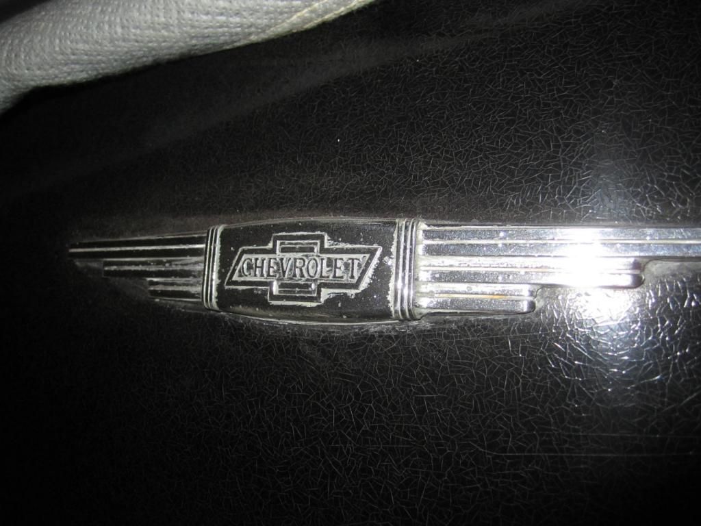

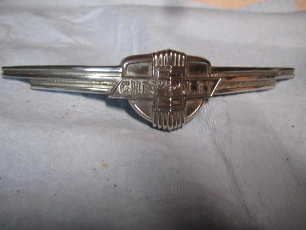

Grill Emblem....
Hub Cap
Trunk Emblem........as you can see the paint on the trunk lid is bad.

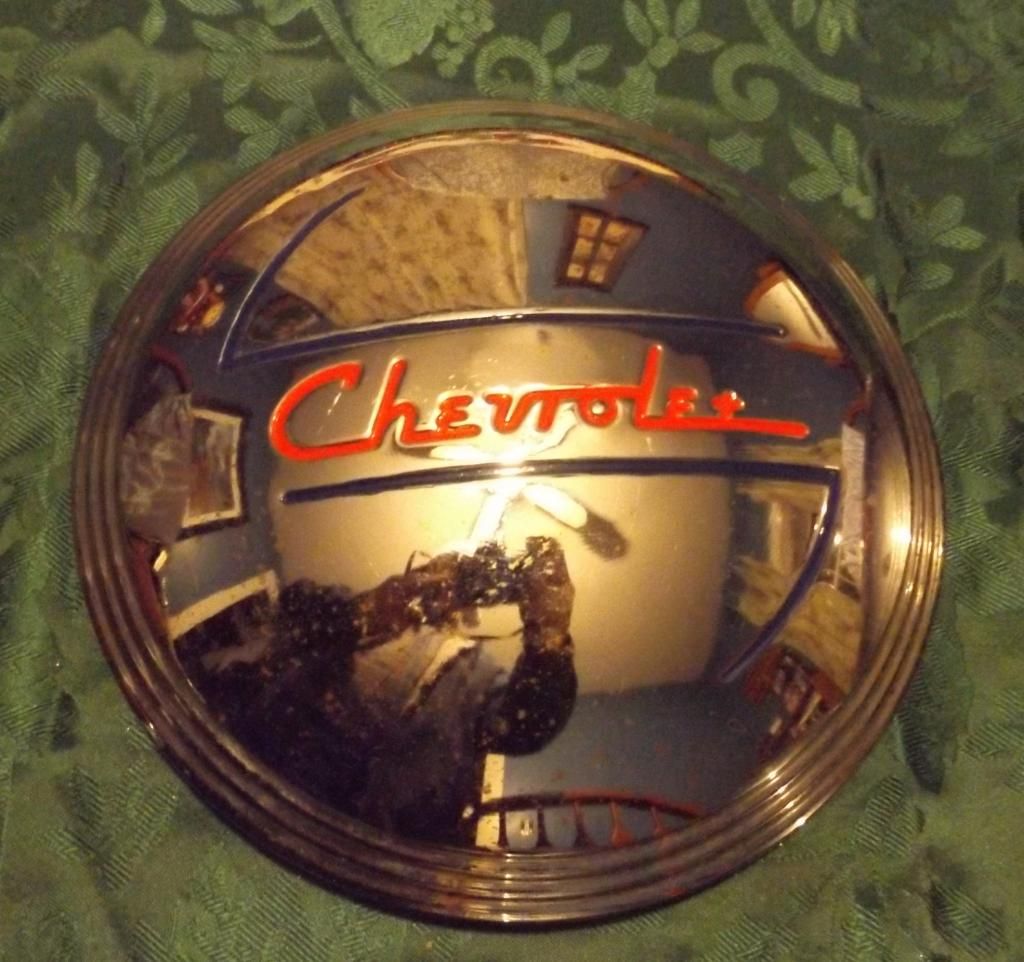

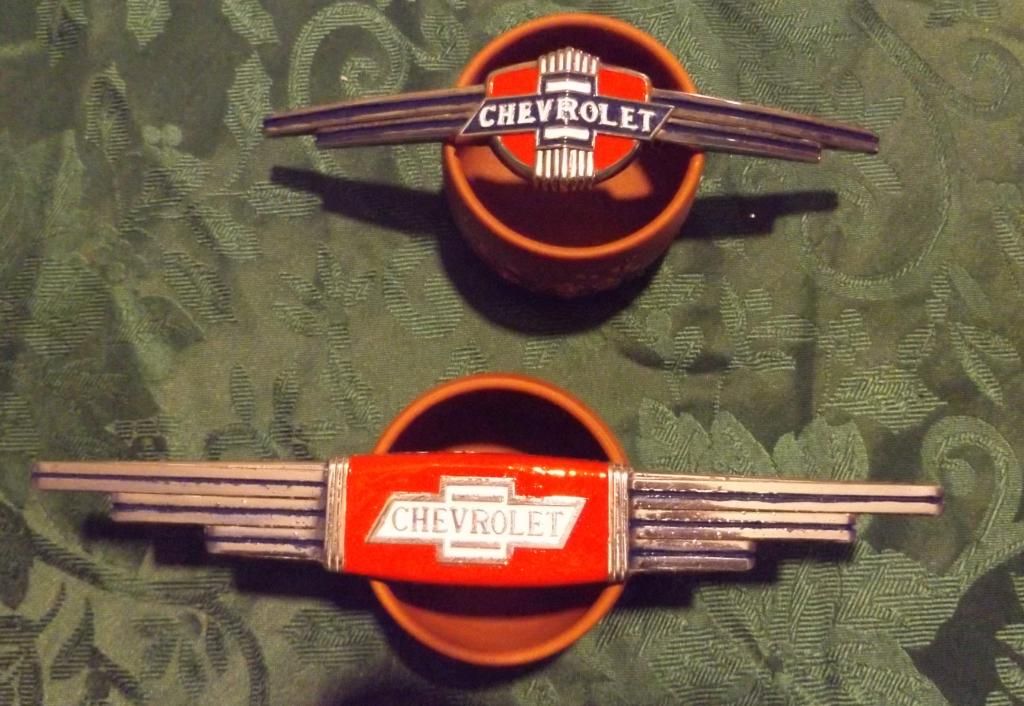

I tried different size artists brushes but settled on a long thin tip brush that is listed as a script brush.
I should probably replace the hub caps because they are pretty rough but the paint is cheaper than a set of new hub caps.
Here is my first attempt with the hub cap......
The grill emblem looks pretty good......The trunk emblem I painted because it was pretty rough looking. I may try to high light the bow tie and the Chevrolet script in blue. I'll check with Hobby Lobby about their brushes.
The hard part.......was the light reflecting off the chrome.....damn.

Hey, I think that you did very well with the hub cap etc.
