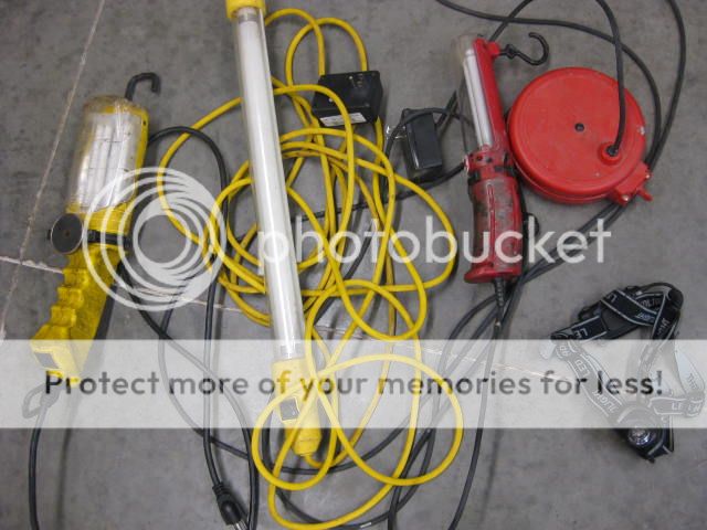

Good lighting is also important. I use a small florescent light with a magnet attached to it for sticking it on the frame or underbody. They usually come in several designs. The key is having the magnet adjustable, so you can point the light in different directions. The light should also be light enough to be held in place by the magnet, so it is not falling off the frame or underbody. I also have a light that I can wear on my forehead, but it is sometimes very frustrating because of the angle it shines and because of my bifocals.

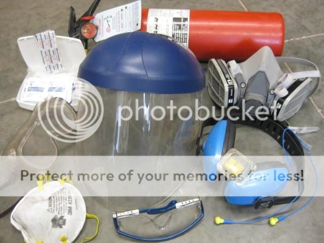

Some safety equipment that we should all have and use.

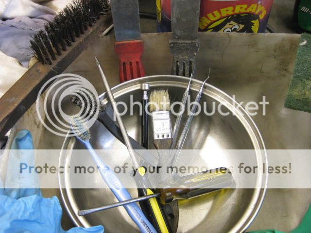

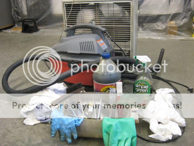

Common cleaning tools and materials.
Tools for cleaning the little stuff. I use a magnet to fish for parts and to stir the parts in gas.
As I age good lighting has become a priority. It seems you can never have too much light. These are all old technology. I need to pick up an LED light source to enter the 21st century. I always cover the lens of my lights with clear tape. This keeps them from getting all scratched up and exposed to chemicals. When they get nasty looking I just peel the old tape off and put new on.
