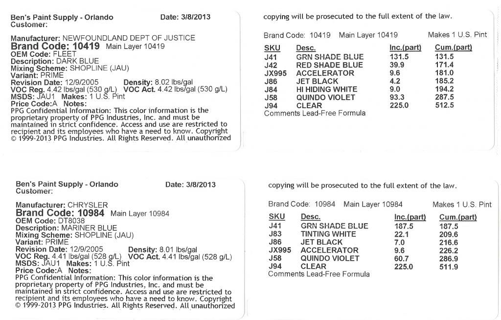

The Center told me that the color of the bowties on my hub caps was 1954 Mariner Blue and sent a link to PaintRef.com that shows modern paint codes for the color. PaintRef.com shows that DuPont used one code for Mariner Blue for all model years of Chevrolet AD Trucks '47-'55. But it also shows that PPG has two codes for Mariner Blue during the same period. PPG #10419 is for model years 1947-1952. PPG #10984 is for model years 1953-1955. (???)
> Chevy Trucks with Mariner Blue
Here are the PPG paint mix formulas for '47-'52 Mariner Blue (PPG #10419 on the top), and for '53-'55 Mariner Blue (PPG #10984 on the bottom). A local PPG store printed them for me to confirm that they are two different colors. Although the "Manufacturer" does not say CHEVY TRUCK, I was assured that each PPG mixture number produces only one color. I did not have them mix the older color PPG #10419.
> PPG Mariner Blue formulas
