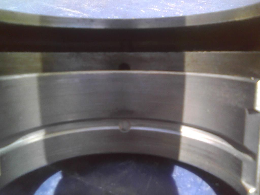

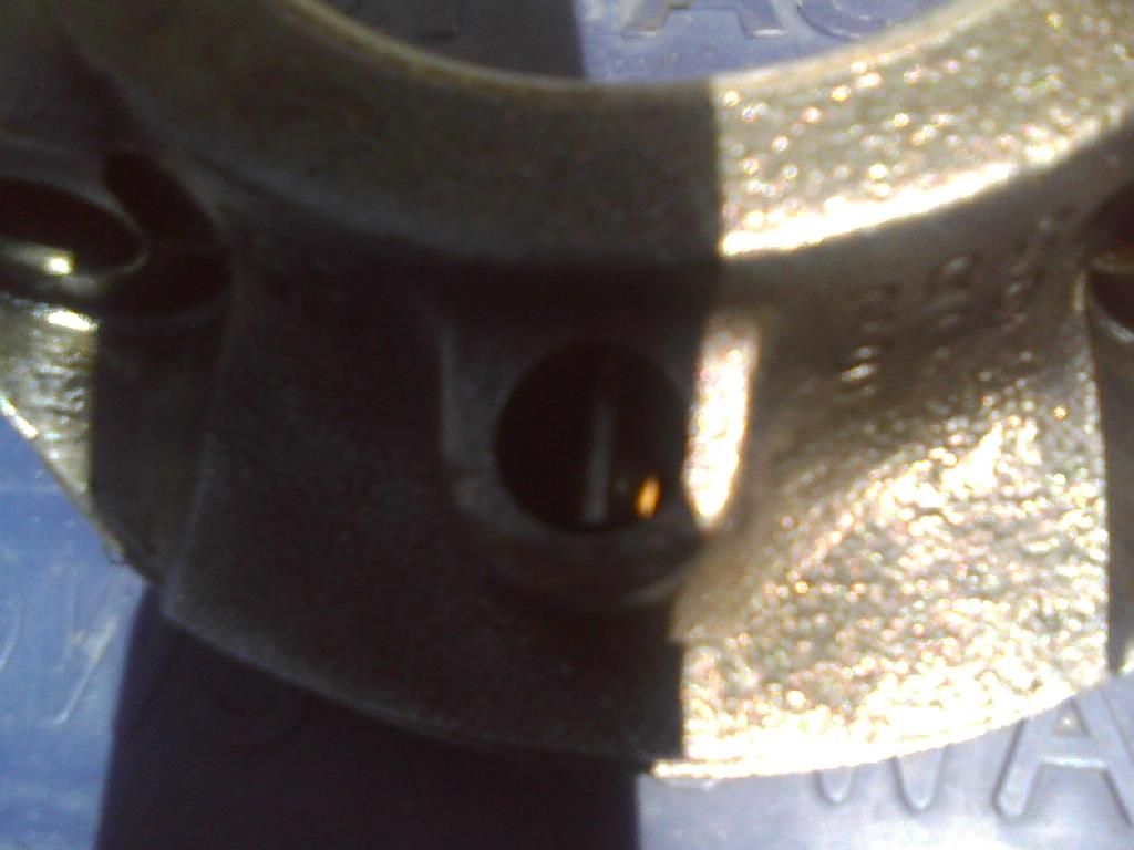

Thank you chev nut, I took out my oil slinger out of my 39 and it just don't look right would you be able to tell me whats wrong with this picture. It leaks
[Linked Image from i1179.photobucket.com]
The oil slinger is "built in" to the crankshaft - part of the forging. It can not be removed. What you removed is the rear main bearing cap which contains the bearing insert or shell.
The shell is incorrect. should be wider and cover the entire surface of the cap and block right up to the return grove.. Also the 1937-1939 insert has another smaller grove and return hole.
The crankshaft has to be lowered to install the top shell. mad

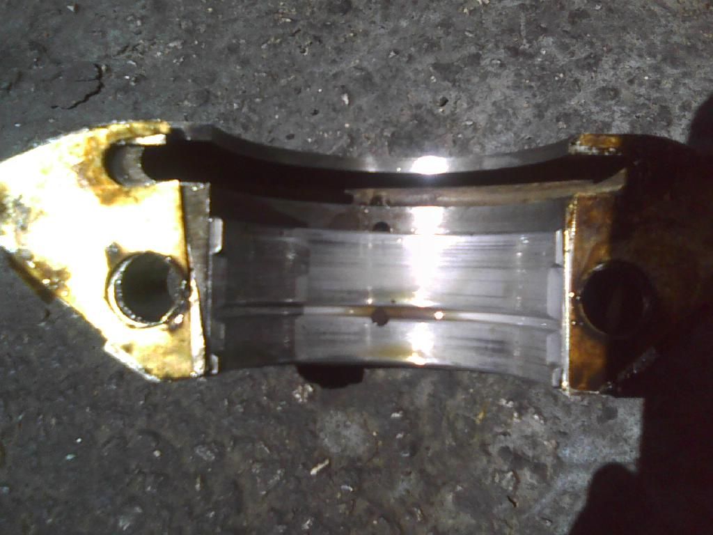

Thank you, I knew this did not look right and I had this motor rebuilt. Would you know where I could get the correct shell for this? I plan on removing the 216 motor, but really hate to do it. mad
If the engine was rebuilt I am sure they turned the crankshaft to an undersize so you will need to know what under size was used. Iy should be stamped on the back of the shell. Egge Machine could possibly help. Also the bearing will have to be re-adjsted with the shims.
