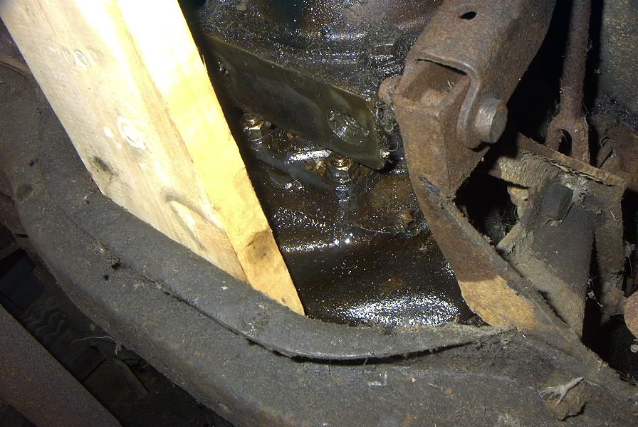

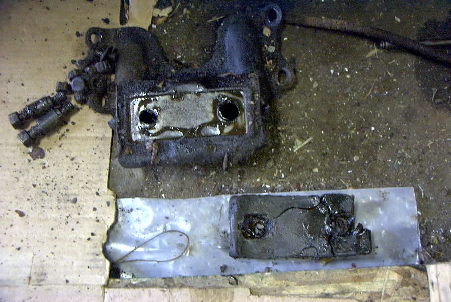

Ugly discoveries today!
I knew the transmission mount was bad but it was worse than expected. Turns out the two studs holes are stripped out from being loose and slamming around for years. The tranny tail will have to come off and a new one found... or maybe have an insert threaded in if its cheaper than locating a used part.

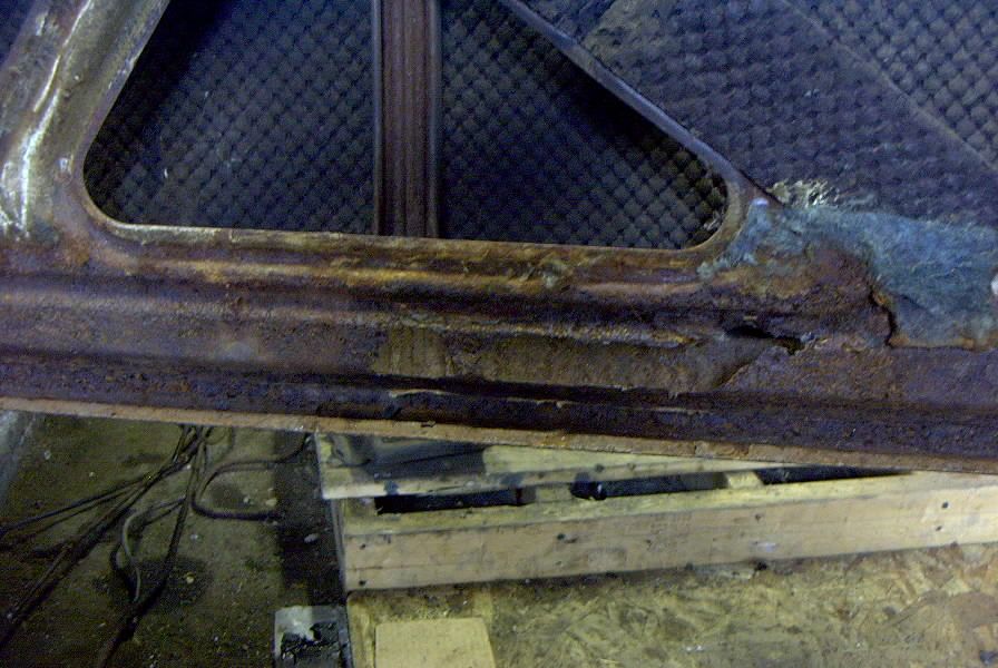

Found some bad rust in the lower door so i'll have to attend to that also with a patch...

Can you put Helicoils in the striped out holes? They would be good as new if you did.

Okay, what do we have here...? Tranny-Tail has two stripped holes...? You or a friend have a Drill-Press...? With the Heli-Coil Kit comes a drill and tap you'll use before threading the insert...Perhaps this friend has had to buy this "kit" already and you can borrow the drill & tap from him...Saves you some $...You probably have an idea where were going with this already, or your local machine shop could take care of it...in a week or so.
You could probably take care of this with a good variable speed hand-drill...The Heli-coil Kit itself isn't going to break the "bank". $15-20 Bucks...Includes a 1/2 dozen or so inserts...
Posts: 3,008
Posts: 3,008
With the threads stripped out you may not even need to drill the holes. Just tap and insert the helicoil. I have done it many times. I was a Machine Repairman/Toolmaker the first 25 years of my working life.
See you Touring the Back Roads
Joined VCCA June 1, 1961
A thread insert kit is probably going to cost about $75.00. You get the drill, the tap, a driver and some coils.
I have some oversize self tapping studs made specifically for this repair. I don't believe I have ever used them but I will send a pair (cheap) if you would like to try them. I don't think trying them would preclude the helical fix, if they failed.

I have a box with three pair of transmission mount studs labeled "Oversize Rear Transmission studs for 1934 - 41 Chevrolet". They were manfactured by Champ-Items inc of St Louis Mo, who knows when. The repair requires that the transmission mount attaching holes in the transmission case be re-threaded with a 1/2-13 tap. Each pair has instructions for making the repair.
The first thing you need to find, before you attempt a repair, is a new transmission mount assembly. The rubber compound was originally bonded to the mounting.

I picked up a NOS mount on ebay last week so i'm good there, i'll bore out the holes for either a helicoil or oversize studs. Tonight while removing the splash guards I noticed the drivers side engine mount rubber is gone... i'm surprised the 206 isn't laying on its side doing the twist in there... lol!
