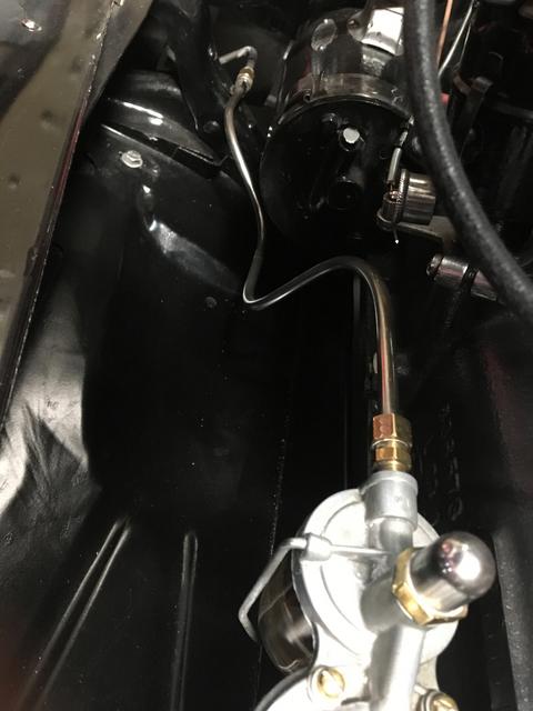

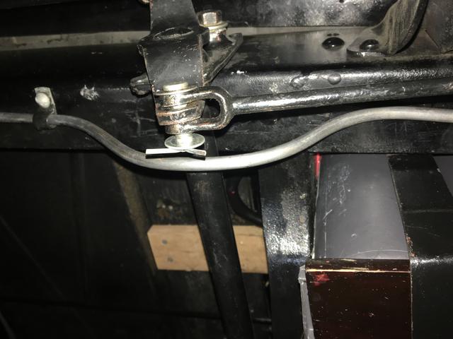

Tom, maybe these of my '32 can help. I can take more if you need.
[Linked Image from i.postimg.cc] passing under battery box at cross shaft
[Linked Image from i.postimg.cc] looking aft from fuel pump

Thank you. That does help. I was tempted to run my new line between the brake cross shaft and the frame, so it would run inside the frame rail like the pictures in the original post, but if the original was one piece from the fuel tank to the fuel pump, it would have to be routed around places like the brake cross shaft and the rear shock.
Tom
The original fuel lines for 1931 and 1932 were one piece tin plated steel from tank to fuel pump. I have made a few over the years. Used 5/16" brake line which is easy to bend by hand or with basic bending tools. Not too difficult if you take your time and double check all bends.
