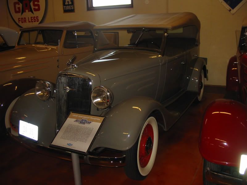

Hey Guys,
I don’t know if this helps or not, because I don’t know anything about 34 or 35 Roadsters. I do know about 36’s, I own an Australian Holden Body Chevy Roadster. I have personally seen American Fisher Body Cabriolets, a South African Roadster and an Argentinean Roadster, and they all used different windshield and posts. Here is a pic of my 36’s windshield.

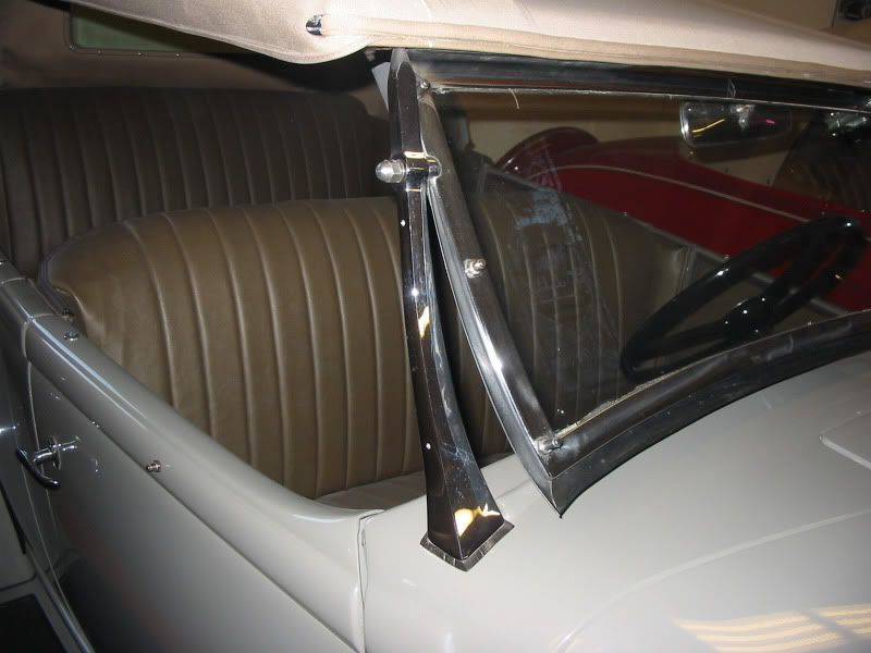

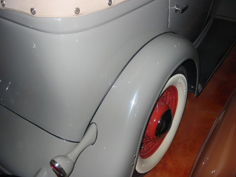

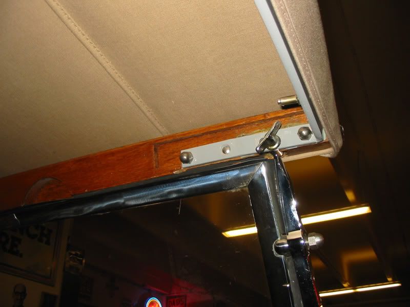

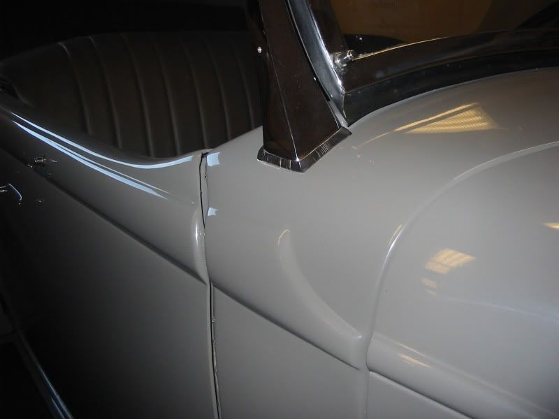

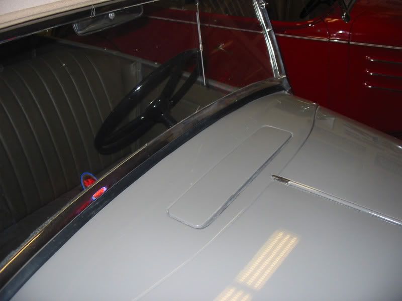

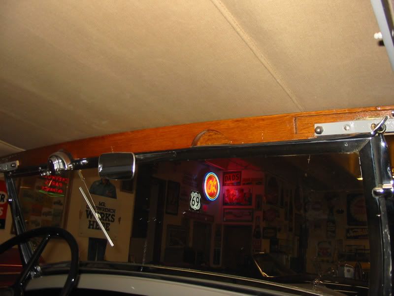

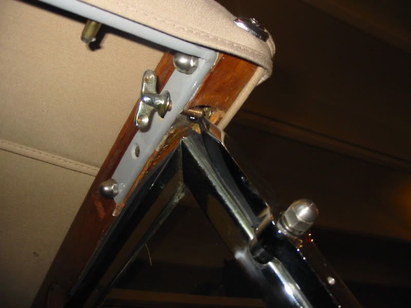

Should have responded earlier.Here are pics of the 35 Holden here that I restored. Definately a Holden body with a Jan 35 casting motor. Always been a left hand drive as the Holden dashes are welded in and this on has not been changed. No indication of ever having the steering gear on the right side either.Maybe built for export? Windshield posts were chrome when it came here. Also notice the rectangle cowl vent. Hope this helps. [Linked Image from i118.photobucket.com]
[Linked Image from i118.photobucket.com] [Linked Image from i118.photobucket.com] [Linked Image from i118.photobucket.com] [Linked Image from i118.photobucket.com] [Linked Image from i118.photobucket.com] [Linked Image from i118.photobucket.com] [Linked Image from i118.photobucket.com]

61 VERT..........i just spotted those pictures you posted, must have missed them as this thread moved down from the main page of current interest.
Excellent pictures of the wood header front piece and the attaching hardware. Gives people an idea of how these cars went together.
Another 6 weeks for my 34 roadster to sit in tennessee before it gets brought to its new home.
