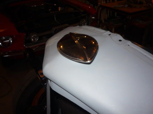

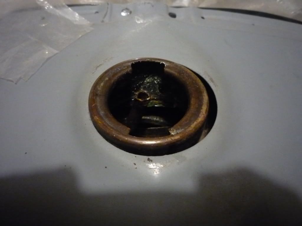

I did what Ray suggested & bought a battery pack. It lasted a couple of minutes and needed a charge. Today I installed the rad to try & start it. Looks like I have the wrong upper tank since my new FS rad cap won't fit. I think I have the correct one buried behind a row of flower pots under two feet of snow.

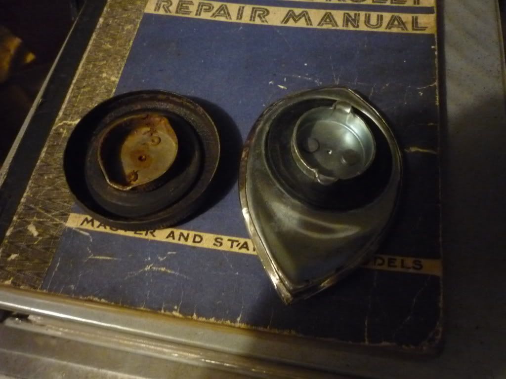

it looks like a TRUCK radiator cap, different fittings underneath!

Here's what I have. Which is correct? I see FS has both the truck & car application under the same part number.
