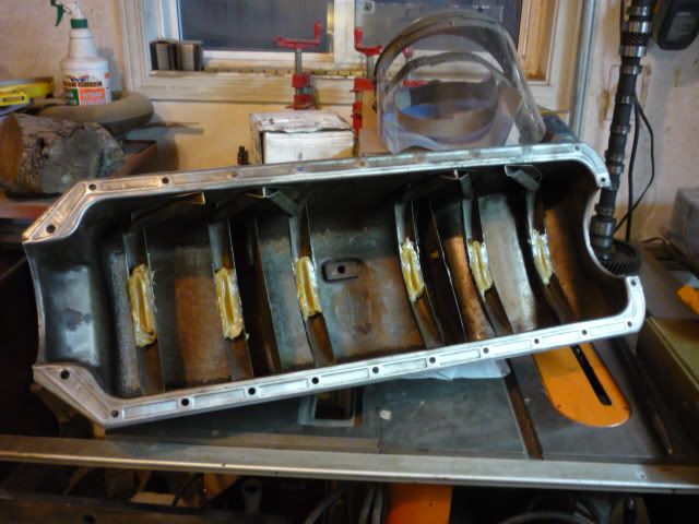

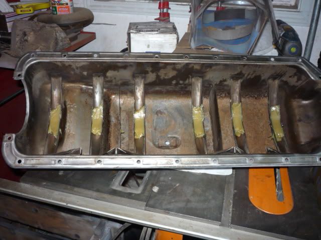

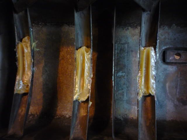

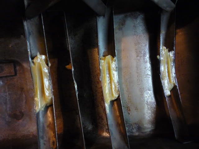

Did the grease test today. Installed line up studs for the pan and laid it on the gasket . Are the resulting grooves what I'm looking for? The front one is the shallowest.
When the pan is bolted tight to the engine the gasket will compress a bit and all will be dipping deeper. The front one may then get as deep as the rest when the end cork gets depressed.
The dipper can also be "tweeked" a bit so it dips lower.
Om my '34 I up-graded to the 1935-36 dipper which has a wider mouth.
They all look okay to me. The dip should be between 1/8" and 1/4". Too much is not good either.
