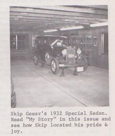

I was browsing through my really old G&D's and found this picture! I thought it was funny that we had been discussing your car, and it's lengthy hibernation...and up pops a pic of the day it all went wrong!! Your garage looks so clean (but dull!) here! For those interested, the "My Story" is also printed in the mag...May of 1975
Wow!! I had totally forgotten about that photo! The photograph was taken when my shop was brand new back in late 1974 and I had just put the old '32 in storage on jack stands. The car has not moved from that spot since then...that is until a couple of months ago. When the car was put in storage in late 1974, I pretty much "furnished" the inside of the shop around the car and a few years after that photo was taken the car was "land locked" and it remained that way for the next 35 years.
Thanks for posting the old photo that appeared in the G&D decades ago!

Great pic with jack stands....
May I ask where the car is resting on the jack stands on the rear? I have to pull out the rear end and can't find a good place to put jack stands except on the spring - which seems unsafe??
Tim
ps... which mine looked this good! Still haven't got the stuck valve loose.
Tim
I have a pair of really old (1930's) cast iron jack stands and the top of the stands are curved to fit the curvature of the rear axle housing, therefore, the rear axle is sitting on the jack stands. That is the safest place to support the weight of the car....that is if the rear axle housing is not going to be removed.
If you are going to pull out your rear axle housing, then the jack stands should not be on the rear leaf springs. That is unsafe as you already know.
