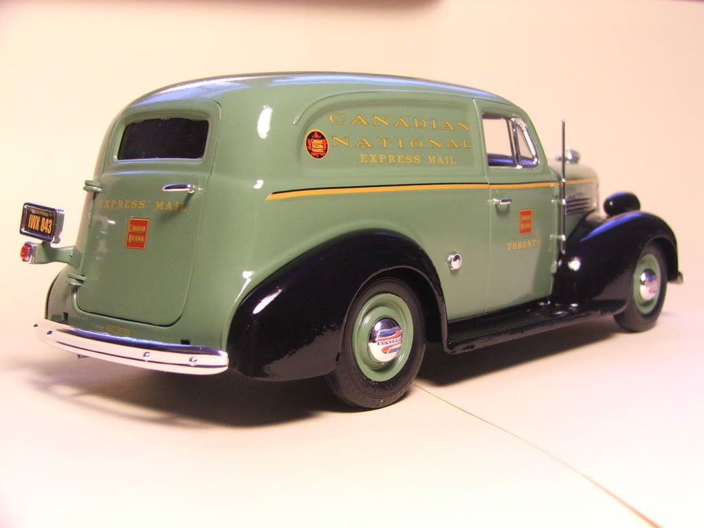

I know most of us in the car hobby started small when we were young. I reentered the model car hobby a few years back with the lofty goal of building a Chevy of every year. In the 1937-1942 range I have completed two, with the plans to build them all. The major problem is that the model companies only ever built two of the years in kit form...AMT's 1937 coupe or cabriolet, or Revell's 1939 coupe or sedan delivery in street rod versions only. I built the AMT cabriolet using all of the factory stock parts, and wiring the motor with ModelCar Garage ignition wire.
The '39 seden delivery was built using Revell's 1941 pickup kit for the stock suspension, tires(hence the '41 hubcaps!), and motor.An AMT 40 Ford donated the front seat, cut in half to make the stock buckets. The AMT '37 kit donated interior door panels, and the cargo floor is built up from another '39 kit, as the street rod does not have the raised floor.

Brewster - you have nice looking models. Be sure to post pictures when you get more of them done.
