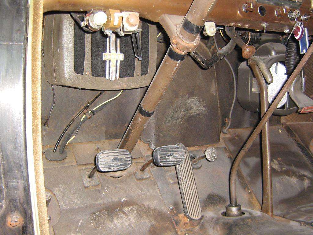

I'd really appreciate it if someone could post a picture of the accelerator, brake and clutch pedals of a '39.
I'm more interested in the position, size and shape of the accelerator pedal as I think my accelerator pedal has been modified and it's so high up its really difficult and uncomfortable to use. As much detail as possible would help me a lot. Thanks in advance.
Attached image shows pedals as they are now, is the accelerator correct?

I don't believe it's correct. Below shows my 38. Of course it could have changed in 39. If so someone will tell us.

Those pictures are great, thanks. I've found exactly the same gas pedal for sale in a couple of places listed for a '39, so I'm now certain it's been badly modified. To use the pedal now I have to hold my leg in the air, which makes it almost impossible to drive.

On RHD Australian 39’s there is a cross over linkage on the engine side of the firewall. The accelerator pedal (about 160mm long with rubber covering) is pivoted at the bottom end on the floor,and the upper end has a short through rod connecting to the cross over shaft, the pedal in your pictures look like a hot rodder pedal from the 60’s,

Thanks for the info, the crossover shaft is there as you say, the pedal is a real botch job, made by someone and then modified by others, it has sections welded in and was even welded into the crossover shaft. I've made a new pedal from stuff I already had and a new shaft from an old scissor jack handle! Got to get dimensions of it as good as I can now.

Finally got my gas pedal sorted, made myself a new one and devised a linkage to operate the wrongly positioned cross shaft. Applied a rubber pad cut from an old car mat. Now works a treat and is comfortable to use. Multi holed linkage is temporary, but now I know it's OK I'll make a better version.
See pictures attached.
