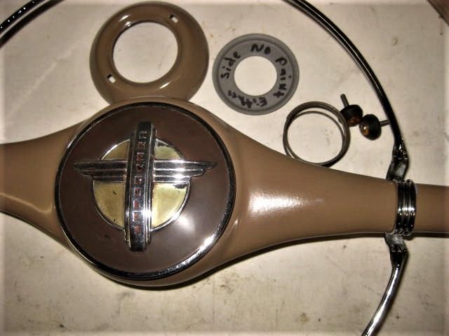

A common problem with getting horns to sound is getting them grounded where they attach to the inner fenders. So before trying to adjust the individual horns make sure they are well grounded. Fresh paint on certain horn surfaces will cause problems. Here are a selection of pictures to help you with identifying all the parts.
Once the horns and relay are working you are ready to assemble the steering wheel and its horn parts.

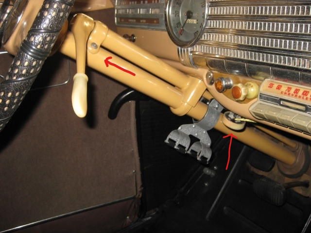

Description: Screws holding shifter in place and horn button under dash

Description: Special Deluxe steering wheel with horn ring, horn cap, trim molding on wheel, 2 cushions with screws, support cup contact spring, contact cup
Description: Rubber pad mounted on back of chrome Blowing Ring
