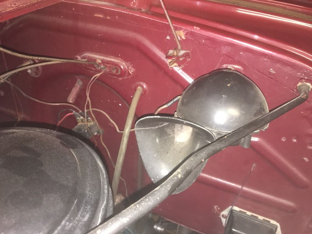

Hello,
My stock firewall mounted horns do not work. Any suggestions? I found the horn relay, it seems and cleaned the contacts. I cleaned the S spring located in the steering wheel. and confirmed the horn wire coming from the steering column, but no sure if the wiring is connected or correct.

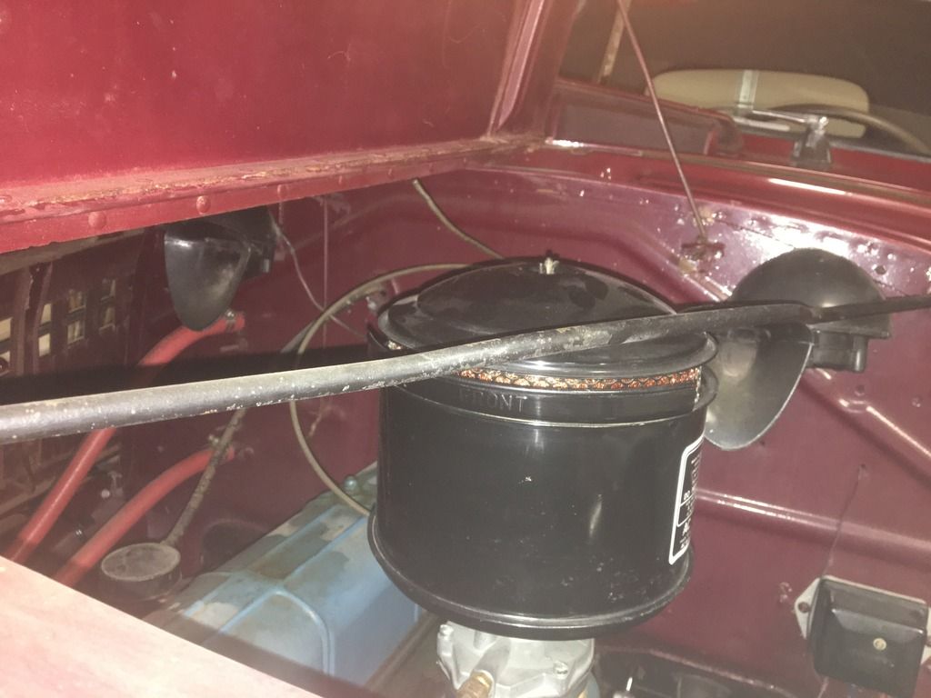

Posted By: solafide Re: Firewall mounted horns - 05/07/17 01:57 PM
Actually neither, must have been some horns added by previous owner. Both go to the three prong horn relay.
[Linked Image from i957.photobucket.com]
Posted By: Tiny Re: Firewall mounted horns - 05/07/17 02:57 PM
Definitely not original but will likely do the job. If the relay is the same as pictured HERE the center lug is power in. The lug on the left goes to the horn(s) and the lug on the right goes to the horn button.
