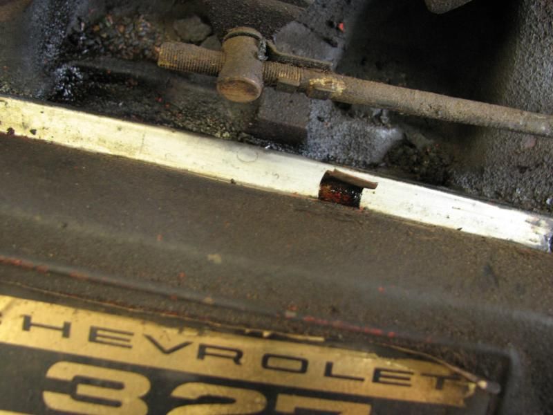

Posted By: Verne_Frantz Re: 1964 Chevy 327/300HP Valve Covers - 07/10/14 06:32 PM
The C is there Bill. It's faint though.

Posted By: Billu38 Re: 1964 Chevy 327/300HP Valve Covers - 07/10/14 07:16 PM
Yup, I found the "C" on all the covers after I stripped the thick repaint off…Billu38

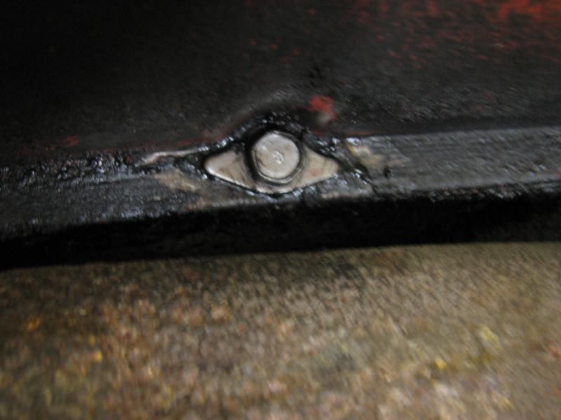

Posted By: Verne_Frantz Re: 1964 Chevy 327/300HP Valve Covers - 07/14/14 04:42 PM
Neither of those are correct Bill. They should look like these.
Verne wink
[Linked Image from i83.photobucket.com]
Posted By: Billu38 Re: 1964 Chevy 327/300HP Valve Covers - 07/14/14 08:35 PM
Verne….isn't the 452 item like the one you show in the photo? thx..Bill
Posted By: Verne_Frantz Re: 1964 Chevy 327/300HP Valve Covers - 07/15/14 02:33 PM
The "footballs" are correct but the bolts do not have the recessed heads.
Verne wink
Posted By: Billu38 Re: 1964 Chevy 327/300HP Valve Covers - 07/15/14 02:35 PM
They should have a TR on the head…right? thx..Billu38
Posted By: Verne_Frantz Re: 1964 Chevy 327/300HP Valve Covers - 07/15/14 07:04 PM
Bill,
Look at the picture I posted. The bolts do not have a TR on them. It's hard to make out just what it is, but it's definitely not TR.
That photo is of an original '64 300hp built in late '63. And it's a Flint engine - the same as yours.
Verne wink
