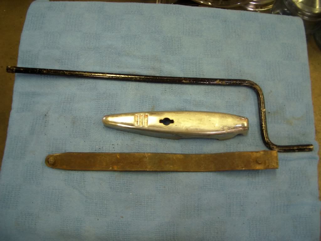

I have a 38 front, center bumper guard that attaches rigidly to the bumper and to a bracket that runs back to the chassis cross-member...all which I'm pretty sure is original. It does not pull down. All the pull down type bumper guards appear to be for the rear, to clear the trunk when it opens. With that said, how was one supposed to get the crank handle in without disassembling the front bumper guard. Why wasn't it a pull down like the back? thx. Billu38

I HAVE SEEN ONE WHERE THE OLD OWNER GOT CREATIVE AND DRILLED A CRANK HOLE IN THE FRONT GUARD. BUT THAT HAD BEEN THE ONLY ONE I HAVE SEEN. MAYBE MOST OWNERS KEPT THEN BATTERY CHARGED?
Posted By: wawuzit Re: 38-39 Pull Down Bumper Guard - 02/26/13 05:45 PM
The reproductions don't have the hole. The orginals do. The hole is not round, it's keyhole shaped.
[Linked Image from i1302.photobucket.com]

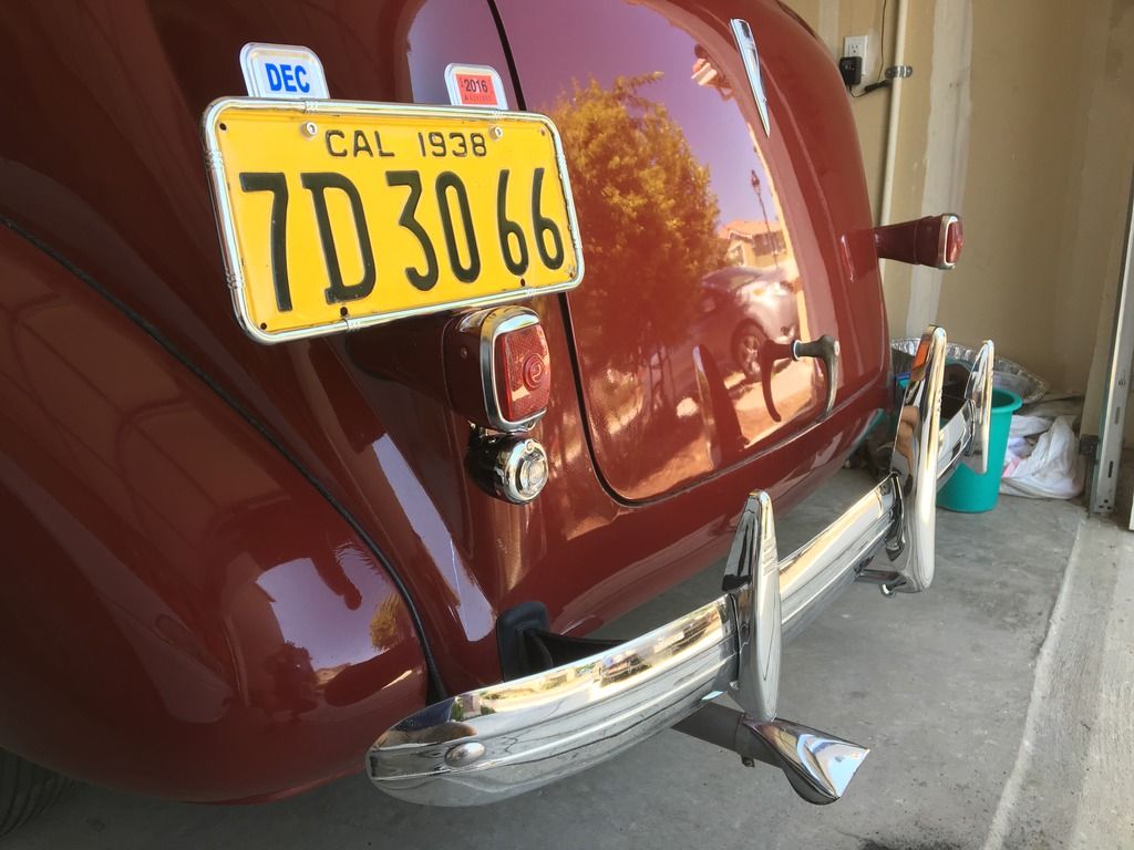

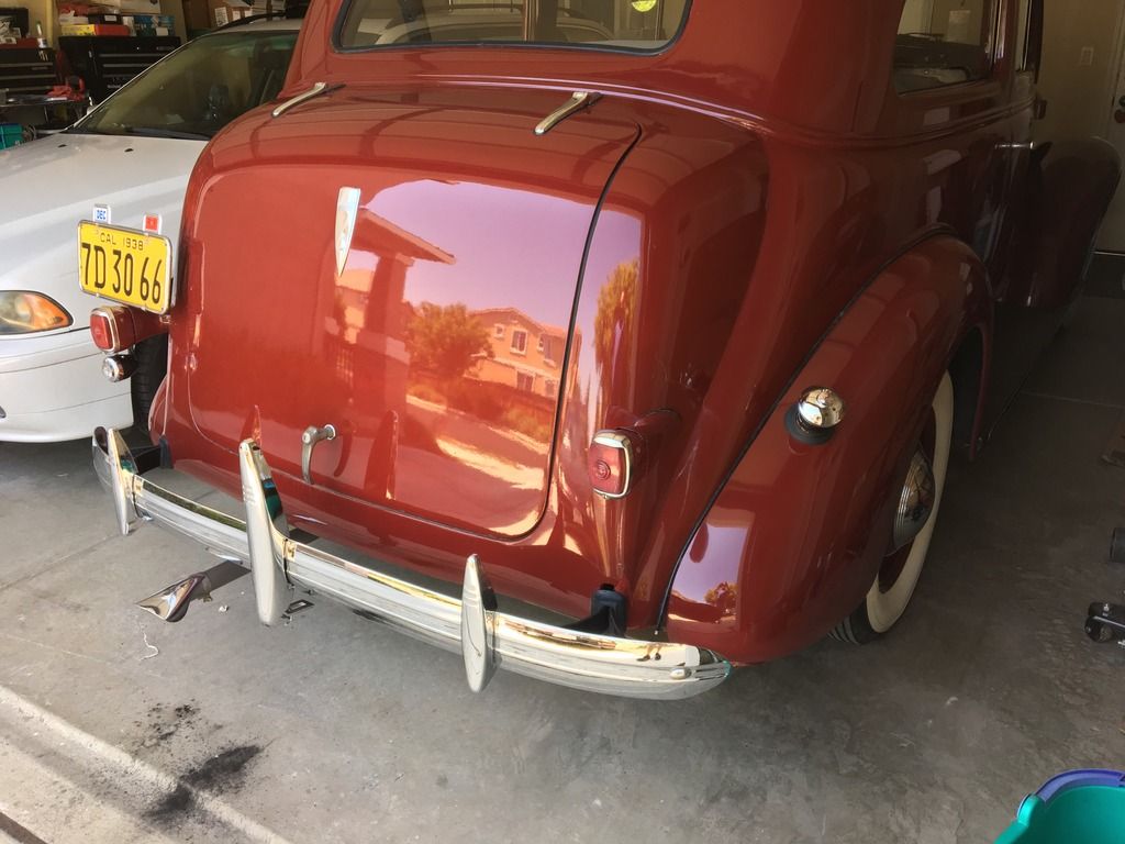

Hung my new folding rear bumper guard and backup light. I didn't install braces yet. Next up parking light. I am searching forum for instructions to install parking lights. I think Tiny added pics, but can't find it yet.
[Linked Image from i957.photobucket.com]

looking good Mike!
