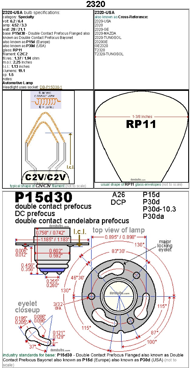

Posted By: bigbth Re: Headlight Bulbs - 06/15/11 05:47 PM
According to the parts manual the original 38 headlight bulb is:
[Linked Image from ted-llc.com]
Brian
