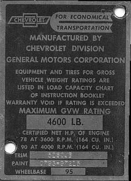

If one removes the "07" from the final example, it starts to look a lot like a Dupont paint formula number. The owner of that van is in fact checking to see if 93-97215 is a valid Dupont code. Here's a picture of that body tag just so you know I'm not making this up!

  • From a 1965 Greenbrier: 0793-97215
This turned out to be correct. 97215 is the Dulux (enamel) code for the '65 Chevy car color Sierra Tan. The regular Dupont number for that color is 4626-L. The owner of the vehicle compared a chip of Sierra Tan to some remaining original paint on the vehicle and got an exact match. yipp
Here's a picture of part of the \'65 Dupont paint chart to validate what I'm saying.
Apparently in St. Louis, where this Greenbrier was built, facilities existed to spray only enamel.
