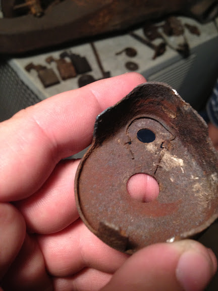

In the process of taking a bunch of these apart he found that some have round weights and other have square. Some of the spring covers have cut outs and others do not.
[Linked Image from lh5.googleusercontent.com]
[Linked Image from lh3.googleusercontent.com]
Does any one know what this small spring inside the cover is for? It was in the three that we had off to look at.
[Linked Image from lh6.googleusercontent.com]
It has been awhile since I rebuilt mine, but I think It Is called an anti-rattle spring. Yours Is broken, since It extends across the hole and inserts into the slot on the shaft, If I remember correctly.
