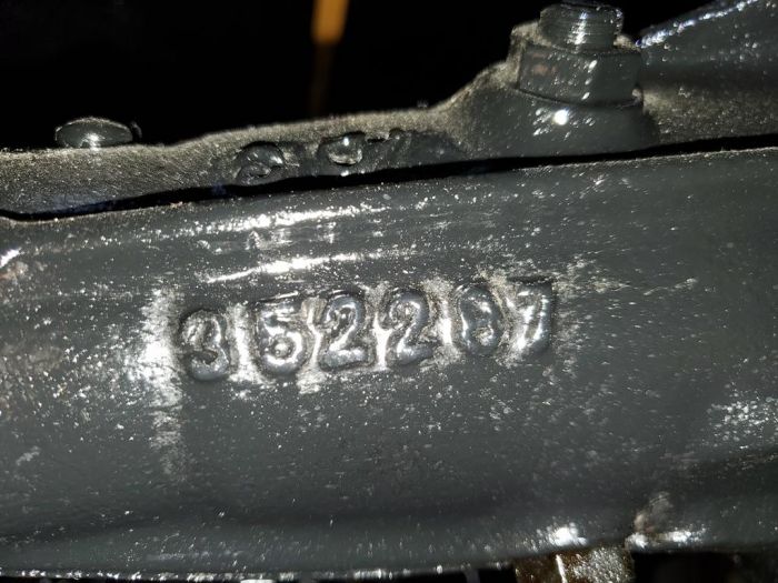

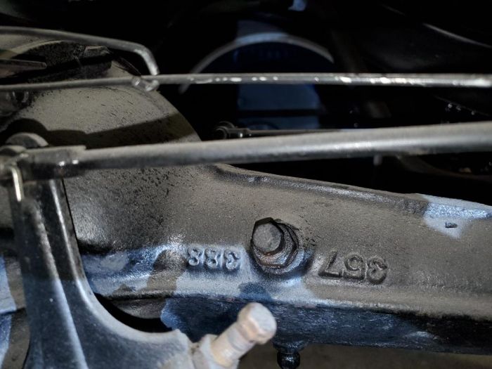

i have a 29 and 30 and those numbers are CASTING numbers, NOT part numbers...
1929 number on drivers side: 352287
then a serial number boss, with number stamped on the passenger side
1930 number on drivers side: 357388
with a cast date 1-7-30 (also cast in)

Posted By: BearsFan315 Re: Need help with apart number for 31 - 01/22/21 11:42 PM
looked in my 1929 MPPL, 1929-30 MPPL, and the 1929-32 MPPL and numbers carry over for each year , this is the excerpt from the 1929-32 MPPL

1. I bought a rear end casting number 357388 no part number or casting date. The spring to axle attachments have numbers unique to 1931, Also all the other parts that came with the purchase were 1931 and the car it came out of was a 1931coupe so 99.9% sure it is a 1931
2. I checked my 1931 chevy phaeton. The rear end has the same Casting number 357388 it had a casting date of H (August) 25/ 30. You scratch your head on this one as late August is probably early production for 1931, however the engine and transmission are E-18-1 and E-19-1. Either the engine and trans were swapped or the rear end was swapped. The car runs fine. Probably a 1931.
3. My 31 sedan I swapped the carrier assembly out of another 1931 many years ago. I reworked it with new bearings and pinion adjustment this fall. The same 357388 appears on this but no part number or date casting. 99.9% sure this is correct.
4. I checked my 1932 chevy BB 1/2 ton pick up. Same casting number no part number or date code. Has been running fine for years has the original 32 engine and transmission without free wheeling.
5. I checked my 1930 Roadster. Same casting number and a date code of 6/12/30. No part number. This one is correct
I found on the internet( I don't know how to post but I can email to interested parties) a site that gave me the drive shaft lengths 1930 car and 1/2 ton truck 43.13" 1931 car and 1/2 ton truck 45.13" 1932 1/2 ton truck 43.91"
Based on the differences in drive shaft lengths it would not be a good swap between these years especially 30 to 31.
Since the casting number applies to all three years and in absence of part numbers and or date codes you would be hard pressed to know what you have(or want to buy) until you were able to measure the drive shaft length when disassembled......... T Black
