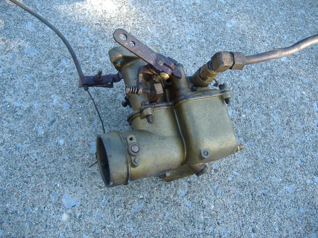

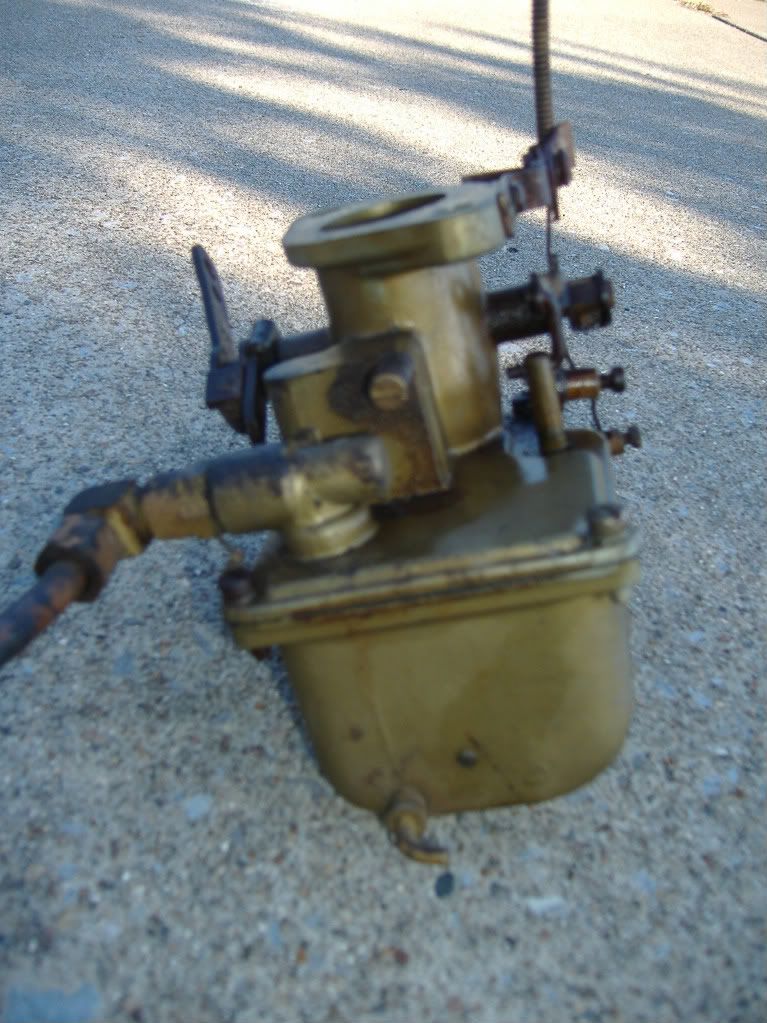

I recently got a used engine with a carb on it. The carb was supposed to be new and only used a few times since the engine was pulled about 3 years ago.
The throttle seems to be frozen stuck. Is this typical of older carbs? I assume it will need a rebuild. I can't find a name on it anywhere.

Unfortunately, I'm almost certain it's not a carter.

It is not a Carter. It is an aftermarket made by one of several manufacturers as a replacement in the 40s or 50s. I don't know of anyone that repairs or rebuilds them.
Posted By: DanR Re: What carb is this? - 10/01/10 12:57 AM

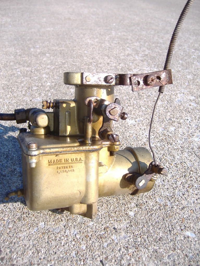

According to the patent number, 1536043, it was invented by Earl A. Bessom, assignor to the Wheeler-Schebler Carburetor Co. of Indianapolis. Patent date was April 4, 1925. If you want, I can email you the 10 page patent document (10 TIF images).

Posted By: Vetteman61 Re: What carb is this? - 10/01/10 01:55 AM
That's really a let down that it's an aftermarket reproduction, though I guess if I can get it working it doesn't matter.
Thank you for looking up the patent number. I don't know why I didn't think of that. I think all I really need is to just figure out what model it is so I can try to locate a rebuild kit.
I've heard of a Marvel-Schebler, I wonder if that is the same fellow?

I've been doing research and research and I believe I found what carb this is. It has no name or markings, as I mentioned, other than the patent number. Luckily, someone else had this problem before. It turns out this carb is a Johnson Model JFA, which goes to .....

P.S. In case anyone else runs into the same problem in the future I did, that carb I posted the picture of had no markings on it. All it had was, as shown, the patent number. For whatever reason, the patent number directed me toward Ford Model A's when I researched them, however the carb is a:
Johnson JC-1, produced by Schebler.
I got this one taken apart, and it would work except that whoever put the accelerator pump together didn't do it correctly and the leather piece on it is messed up beyond repair.

It's definitely not intended for a model A, and it hasn't been modified to fit a Chevrolet. The carb, I found out, originally had a sticker on the front that is long gone.
Apparently the maker would make this carb under several different names, so they would just swap the sticker. I'm not sure why the patent number leads in the wrong direction, at least from what I could find.
