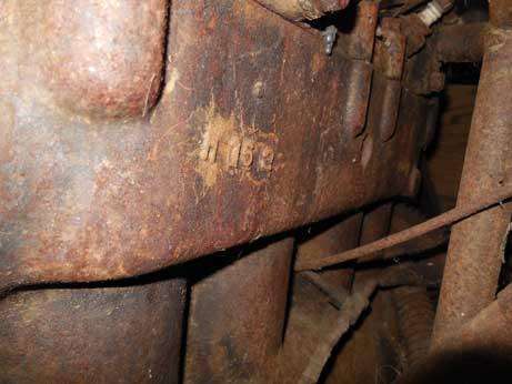

Ok. Heres the block number. 1923? And heres the Remy generator distributor and oil pump combo. Theres another pot metal generator rear cracked as well as a cracked oil pumo. The rear on the generator looks to be brass. Are there any break downs on how the generator dist and oil pump go together?

. Hi Rooster, 327773 is a 1923 water cooled block. My Sedanette has it on the right side between cylinders #2 & #3. First photo. The second and third photos are at Harrah's Reno museum. It has the casting number on the water cooled engine on left front by oil filler cylinder #1. I can not find any casting number on the Copper Cooled engine. Does any one know where it's located and what it's supposed to be? . . .
. For more casting numbers see web page <http://home.znet.com/c1937/Cast.htm>. .

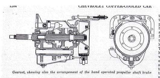

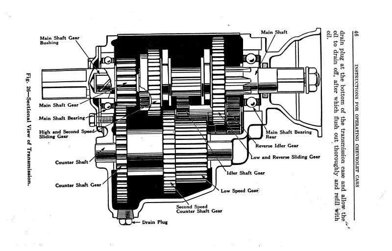

. The Copper Cooled only used the body of the 23 superior. It had a belt driven Generator, automatic advance ignition distributor, Dual plate friction clutch, the transmission had the same ratios as the water cooled but was completely different. See photos. The H2O has square drive in and out. The CC has splines in and out and drive shaft clamp with no E-brake. The rear axle is Banjo housing. .
. Lou .
