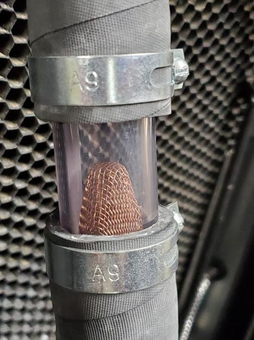

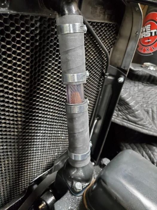

I put it in the return line to the radiator out of the head. see attached pictures. also serves another purpose to see and watch coolant flow. can see if there is air in the coolant as well. how i found out my head was warped ! pumping air bubbles. 1929 Pumping Air Bubbles
i agree with Dave, if you have it recored, have then fill the allotted space, do not go outside the design parameters. and you want a good old school shop experienced in building and making radiators / heat exchangers. we have an old school/new tech shop here that has been doing these since 1947.

I like the ability to see the flow with that filter. Where did you purchase it, and is there a specific size/model number I should look for? I will definitely keep it in mind to appropriately fill the space, and fortunately Rustaholic gave me the name of a shop in my area. I know it will be important to go to one that knows what they are doing.

Here's the link to the see-thru filter https://ganofilters.com/
I installed one in my '32.
That is the place, and actually that is part of Restoration Supply Company.
in there catalog: Rest Supply Co pg15
Part number i got was GAN014
that is the clear option for 1 1/8 to 1 3/8
they come in clear, aluminum or brass
and three sizes
they also make one for heater core lines in 5/8 or 3/4
here is the detail sheet i got with mine when i got it
Attached PDF document
