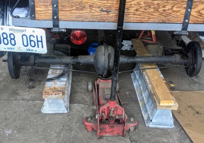

My Procedure on removing rear end. 1) Mount jackstands on concrete blocks after jacking up rear end. (This must be done very carefully 2) Disconnet brakes and tie up. 2) Disconnect 4 bolts around universal joint and use wire to hold up propeller shaft 3) Disconnect rear end from springs while having a hydralic jack under it. 4)Remove the four pinion shaft housing bolts and tie up the housing 5) Tap the propeller shaft housing from the rear end 6) The rear end will then swing down and deposit the oil on the floor. 7) The rear end will then rest on saw horses protecting the brakes.
