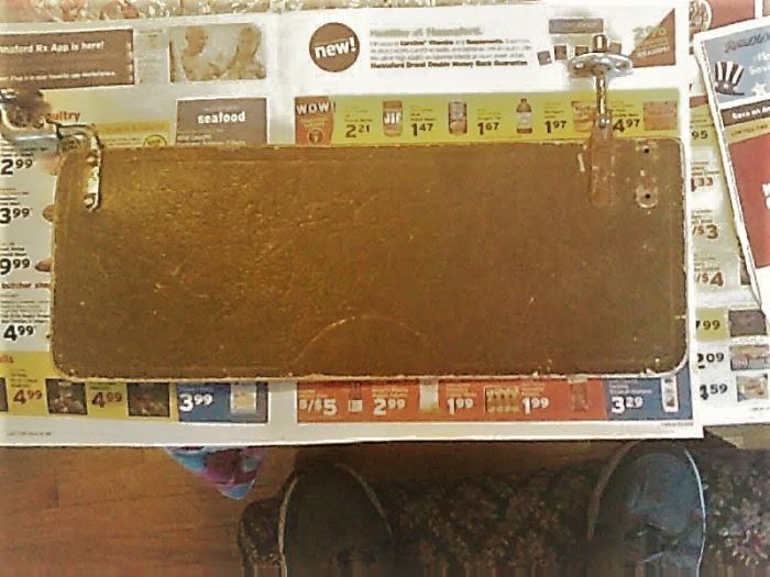

Jon, here are the pics.
The one with 3 sets of holes (Visor 1) is: The left side - about 1" from edge to center of holes. The right side - one set of holes is about 1" to center of holes from the edge and the other set of holes is about 2" to center of holes from the edge.

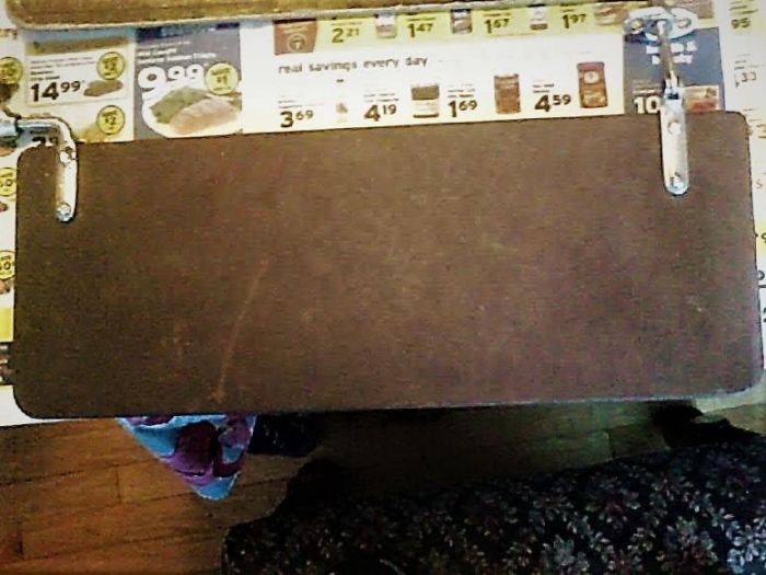

The one with 2 sets of holes (Visor 2)[Linked Image from vccachat.org] is: The left side - about 1 1/4" from edge to center of holes. The right side - about 1 3/4 from edge to center of holes.

Peter, The one with the three sets of holes is for a 33 Master. Someone has made a second set of holes to work on another car. The one with two sets of holes looks like a 35 Master although I can not see the picture real well. Neither one is correct for a 35 Standard.

The Standard Visors IE 33's 34's and 35 Standards have a Leather like look finish. The 35 Master is a harder board and has a "sprayed on like" finish.

My '35 Standard visors are masonite, smooth on both sides, and painted with brown wrinkle finish. One is original to the car and the other one was added by me, 40 years ago. They look like the one pictured with no extra holes. I was under the impression that Master and Standard used the same visor in 1935.

I agree that the embossed visor is for '33 Master. I too have the '35 Accessory catalog which shows this visor, but if I recall, it is for illustrating the vanity visor mirror, and not the visor itself. I will check the accessory Catalog when I get home.

Pete's visor with the extra holes is the one I call embossed. It has a pattern stamped into a paper type product.
