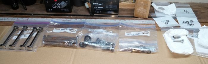

ok been working on my bumper, had to Straighten a 1929 Bumper Mounting Bracket as well as re arc the crossbars.
then 1929 Bumper Groove Painting
ordered new end bumper hardware and found a place that sold chrome hardware, so ordered new hardware for the medallions as well.
spent some time to build the bumper this weekend....

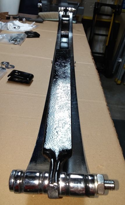

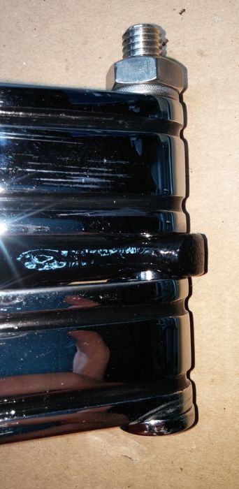

few shots of assembling the front bumper

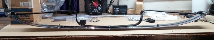

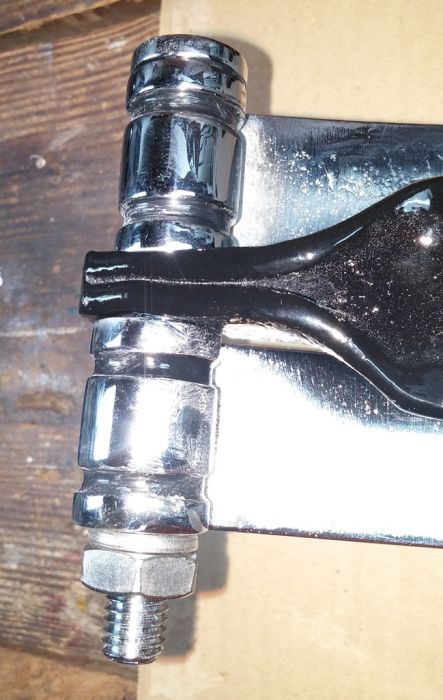

the the rear, was similar, had to reshape the brackets...
all new hardware for ends and medallions.

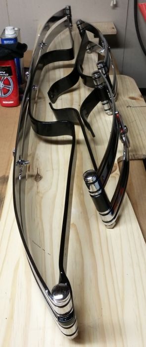

here they are
all ready for installation !!

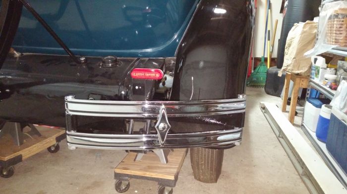

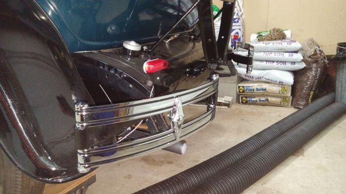

actually installed my rear bumpers today, as well as the signal lights i made up for the car. these are NOT factory but more for safety ( too many crazy drivers out there)
used all new hardware as well, they look great, and notice the spare tire carrier is installed as well
