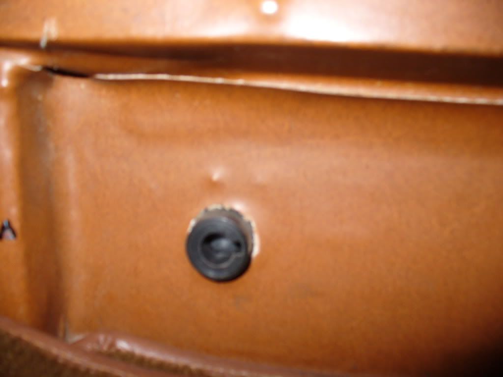

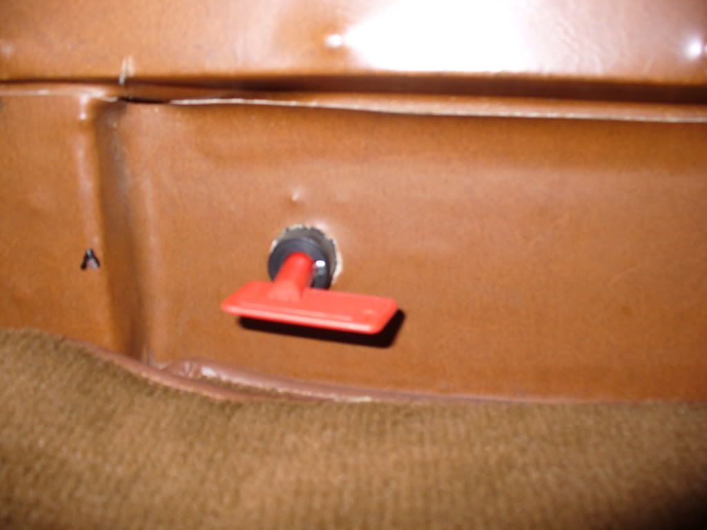

Hi,
I put a battery kill switch on the rail under the front seat that I can get to immediately. No more time spent pulling up carpet and battery cover.
Feel very safe now, see details attached.
http://my28chev.blogspot.com/2011/06/2010-april-installed-battery-kill.html
Cheers
Ray

Hi Ken,
The part is not from the FS but very similar. I mounted it from the back. Looks a bit rougher up close than what it is but the under seat rail of a 28 Chev is not on full view, otherwise I would have made up a dress cover or panel.
Good Luck, please let me know how you get on.
Regards
Ray
[Linked Image from i1091.photobucket.com]
